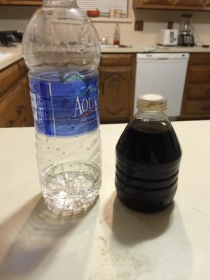

The past few oil changes I've noticed my oil has been darker and darker until it has turned solid black. I drained this yesterday, it has 743 miles on it. ImageUploadedByTapatalk1438780647.988664.jpg
I know this is not normal, and I want to figure out what is causing this as quickly as possible.
So far I have no symptoms of the motor running any different than it should, no lights on the dash or messages.
I also have what looks like oil residue in my exhaust tips.
I'm at 84k miles on my 4.7 and I've ran full syn since 42k when I bought the truck. The oil pictured above smells pretty strong of exhaust as well.

Check your PCV if you have one can't remember off the top of my head if the 4.7 does or not and after that you may a valve/seal issues.

Has fuel consumption changed? Any running issues? Just a random thought, but if the injector spray pattern/atomization gets off, you run the risk of washing the cylinders down and getting more contaminants in the crankcase. Try a couple doses of Techron, or some other good injector cleaner. Also, if the PCV you recently installed was from a parts store I would not assume it is good.

Did you install a diesel? That's what that looks like. You are not getting complete combustion which is why you're creating so much soot. Pull all your plugs and see which cylinders are heavily oiled. Change the oiled plugs and see if that helps out. I would also do a leak down test just to make sure you have proper ring seal. Check again in a few hundred miles. If they're carboned up again then I'd start looking at the injectors, swap injectors between cylinders, if the problem migrated with the injector swap it out for a new one.
No I did not put in diesel oil, but I agree with you. It does look like diesel oil.

Was it like this before you changed your pcv? Soon after? I'd get a catch can as well. I'd get a smog test before an oil test. I can tell you the oil test results without getting it, you have unburnt fuel. It may be helpful to see how much fuel you have in there though.
No it's not normal IMO, if I couldn't get it fixed at some point I'd be thinking trade-in time.

Yeah, can you smell it? Maybe your rings are toast. Just curious what oil are you running?

That would lead me to believe rings instead of something fuel related, which wouldn't be good news. Dunno, I would have a mechanic look at it. If it is rings a heavier weight could help a bit.
No tailpipe smoke?
