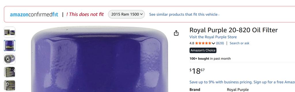

5w30, there is a long reason why just trust me. If you can, get a royal purple 20-820 18 bucks Amazon, again long reason why trust me. Redline cheaper then ever at Amazon, 81 for 6 but buy two = case 10% Off. 162 case - 10% = cheap price.
Amazon says the 20-820 Royal Purple filter does not fit a 2015 Ram 1500.
It fits, they changed the filter spec to the 10-48, but the 20-820 fits it is the larger size and better flow as a matter of fact. The first 3 years this generation had the larger spec. See oil filter thread, only the 20-820 has more holes for flow, 8 holes. Even it's clones the amsoil ea and the Fram endurance doesn't have the 8 holes. Since we are dealing with a tick situation, you want the best flow on the best filter. It is loose spun glass and full flow, I certainly wish there were more options, but this is the one.
That is the correct filter, the RP 20-820, and it most definitely fits. I have one on my 2014 5.7L right now. You are ordering the exact filter that folks here are recommending.
The Amazon computers don't like it because it is over-size, that's all.
OK thanks I will get one.

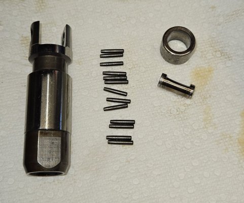

In 2016 they made beefier lifters or should I say needle bearings, that is about it. I don't know about the rebirth e torque 2026 hemi. The new lifters still not a huge improvement to structural issues.
Must've updated before '16. Had a bad lifter in my '15 that I've had since Sept. of '17 with 28,600 miles. Failed at 201k miles. Lifter only had 13 needles in it.
Unless mine had a lifter job before I got it.
