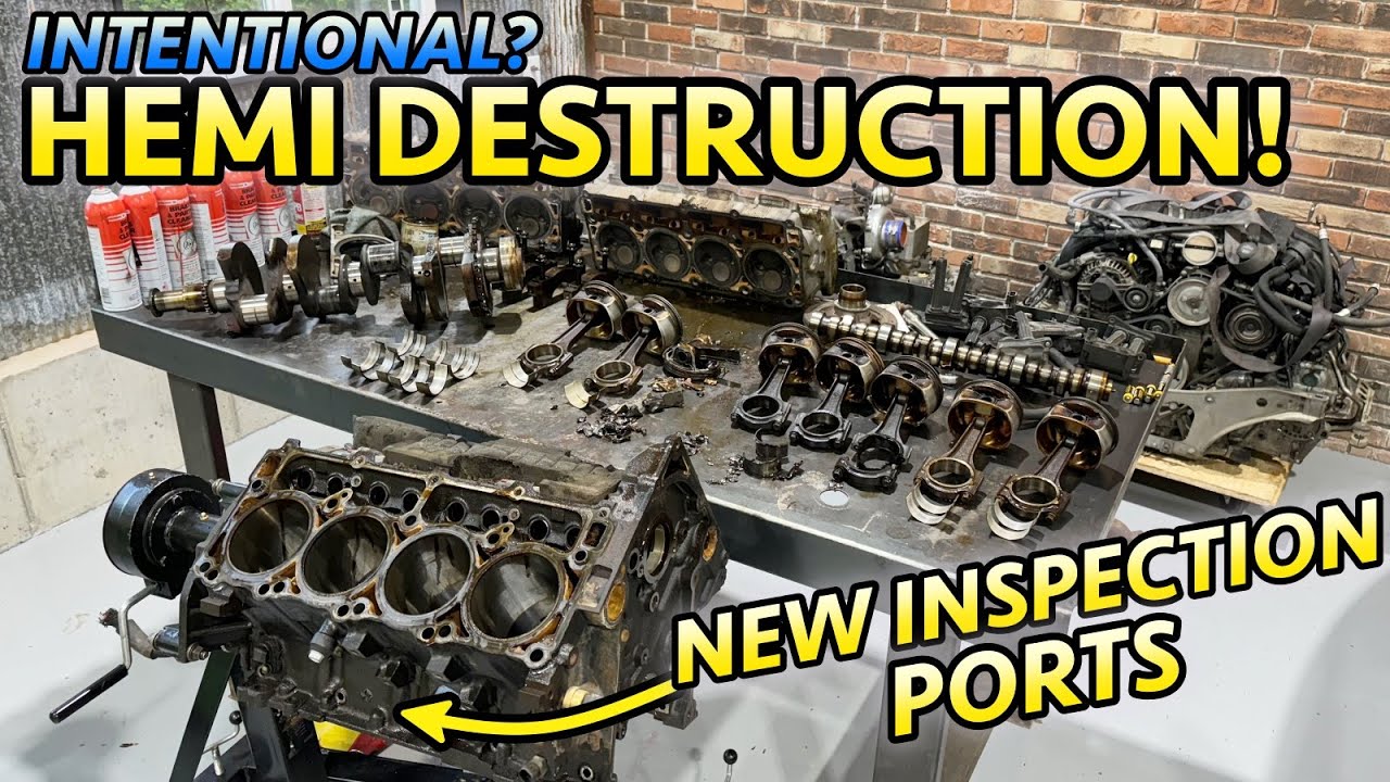

This is the tear down that's really scary,lol
@EdGs check it out at about the 38 minute mark,as that's the main bolt that builds up sludge if you do have a sludge buildup,which you really didn't have
Any theories on why the sludge builds up in that front main bolt area?
About all i have is it's probably one of the coldest spots on the block,as the front of an engine is always colder then the back,due to airflow hitting it,and oil flow slows down to make the corner to the mains.
This video by Powell Machining goes into pretty good detail on the hemi's lack luster oiling system,about the 3:50 mark he shows how the oil makes a turn to feed the mains. It's worth spending the 13 minutes to watch this video.
