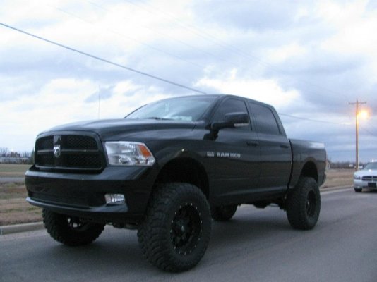

Hey guys this is killing me. I have been taking your advice and I still cant figure this out. I feel DUMB!!! At the end of the convo people keep saying get a BL. I just want the 6' lift Bilsteins and a 1' rear spacer. Can I run a Toyo 37x1350 20x10 -24 offset with this setup????or will I have major issues? I just need someone to tell me what to run here lol
I'm telling you man..sick setup would be 6" rcx bilsteins 2.1", 1.5" rear spacer, and 1.25" or 1.5" body lift, 37 1350s on 20x10 -24 offset...wont rub and sit perfect..only thing will have to do is adjust exhaust tips after body lift..But if you are that against a body lift and not running huge 2.5" fender flares get 20x10 -12 bilsteins 2.1" with 12.50s (13.50s even and trim valence some or remove..i removed mine even)
