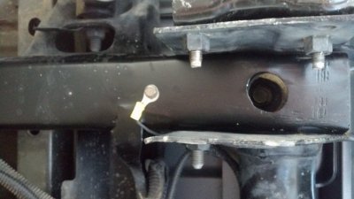

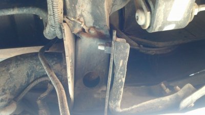

Hey everyone, I am brand new to the forum but have been visiting for a while for great information. Unfortunately I need some advice, or input on repairs made to my truck following an accident. I was at a dead stop and was rear ended by a girl who was texting and hit me at 45+ MPH. The frame was buckled and the bed/tailgate was damaged. I brought it do a Dodge dealership hoping for top notch service...and here is where I need help. Am I being over sensitive or are these repairs sketchy? There are a lot of pics so please check out my album and let me know what you think. Thanks for your time!

I wouldn't accept that as a repair and find it hard to believe a dealer would try to pass that off as a fix.

I felt the same way, I brought it back today and the shop manager acted like I was being picky. Thanks for the fast reply!

Looks like they pulled the stress point to much and pulled it apart, then put a horrible weld job on it.

That's what I though, or they cut it so it would move easier, but I though welding or heating a frame rail ruins it's structural integrity. I do not trust that repair job to withstand a similar impact again. While the weld may hold, the metal around it appears to be overly fatigued now.

Call the insurance company that paid for the repairs and tell them that it was not fixed correctly. Ask them if you can go somewhere else and have a second opinion on the matter. Body shops love taking business away from dealerships.
Also...... welding on the frame doesn't hurt anything. I'm sure somebody will disagree with that, but welding on the frame is harmless.

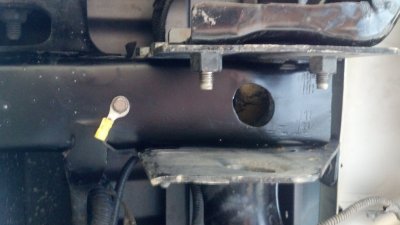

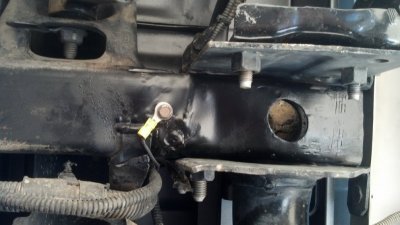

I have an update. I brought the truck back yesterday and they had it ready by the time I left work today. When they called I thought there was no way in hell they could have fixed all of the issues but I am honestly amazed. Take a look and let me know what you think. I also added more pics to the album too.

Now that looks professional. As for structional integrety, welding/heating shouldn't affect it. Big rigs I've been around do have heat treated frames & maybe that's what you are thinking of.

I don't think they did much other than making it "look" better. I wouldn't have given them the second chance on this one. It's fairly easy to hide stuff as a bodyman. I have seen plenty in my years of working in dealerships/bodyshops...
