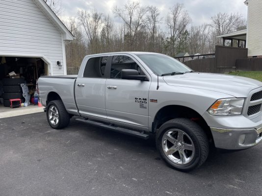

Wish I would have came across this thread before I bought my rear springs. I went with ICON 1.5" rear coils for the Ram, converting from 1.5" motofab spacers w/ stock springs. The height was perfect with the spacers, gave me a true 1.5" lift and about 1 1/4" rake with my front Bilsteins set at 2.8" (only netted about 2 1/2" though).
After installing the ICONs, they netted me only about 1 1/8" and rake dropped to only about 7/8". I can live with the rake the way it is now, but I'm guessing the ICON are going to settle even lower. May have to throw in 1/2" spacers, which I wanted to avoid using.
So the ICON 1.5" for the Gladiator JTs will net a true 1.5" for our 4th Gen Rams?

Yes and then some. JT springs are 1” taller then Ram springs. I will see if I can get you a frame to axle measurement today. Wheelwell heights wont do any good.
