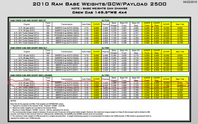

I've circled the two that mine could be
You get 2,000 pounds more max. trailer weight and 2,000 pounds more GCWR (maximum weight that the vehicle can bear when fully loaded as a tow vehicle) with the 4.10 as opposed to the 3.73 :shrug:
I'm going to be towing 10,000+ lbs and the 4.10 has a max trailer weight of 10,450 which is 2,000 over the 3.73. The difference between 3.73 and 4.10 is .37. So theoretically, If I had gears that are 4.47, my max trailer weight would be about 12,450 lbs. Is there a gear size that's close to 4.47? Would the max trailer weight actually be in the 12,000s?

The problem you are running into there is no matter what gears you install (or any other mods) it does not change your 'legal' maximums. Sure 4.56 or 4.88 will tow easier but your legal maximum will still be what is listed for your VIN. Even if the truck came with 3.73 and you install 4.10's your legal maximum is still what is listed for the 3.73's. It doesn't make sense to us that know about trucks and towing but think about a jury hearing and seeing charts stating a trucks max tow rating is XXXXX and you exceeded that and were then involved in an accident?
Also, didn't realize you were towing 10,000lbs. That is quite a bit for a 5.7. Towing that occasionally might not be bad but towing that much too often won't be fun. In my opinion 5.7 is pushing it at 10,000lbs. I have never towed with a 2500 with the 5.7 so can't say for certain but my 2013 1500 with 3.55's ran hard towing 8000lbs. Yeah it was a 1500 but that has no impact on power.
It's interesting to note that for the 5.7 and comparing the gear options, that yes you do get another 2,000# to tow, but here is something to think about and not sure how RAM figured this in but:
Granted you can get that extra 2,000#'s moving, but how are you going to STOP it?
Perhaps there are bigger brakes on that, but I'm thinking its all the same or at least not aware of it.
I look at it this way. sure getting up the hill will be easier with that weight, but at some point you have to come down that hill. :33:

The two factory gear options are 3.73 or 4.10 and there isn't that much of a difference between them. I doubt many people could really tell the difference by the seat of the pants feel between them. For towing performance I pulled a 9,000+ lb. plus trailer for years with a Chevy 2500HD 6.0L gas engine that was rated at 300 HP and it did fine. Sure, a diesel would pull it easier but not like the gas engines won't get it done. The biggest difference is what type of speed you can maintain on the grades on the freeway. If most of your driving is on 2 lane roads at lower speeds it's not nearly as big of a deal as compared to trying to drive 70 mph through the mountains of Colorado. Same thing goes for fuel mileage, if you are spending a lot of time driving slower (under 50 mph) and pulling a lot of grades then lower gears could actually help fuel mileage.
People who make comments about being able to get a heavy trailer moving but not being able to get it stopped always make me wonder if they have actually ever towed a larger trailer before. It's called "trailer brakes"....you know, this concept where the trailer actually has brakes on it to compensate for the added weight. State to state laws are different but in my state any trailer with a GVW (max weight) over 3,000 lbs. is legally required to have brakes on it. There is no way I would consider towing any decent size trailer at posted highway speeds without brakes on it.
