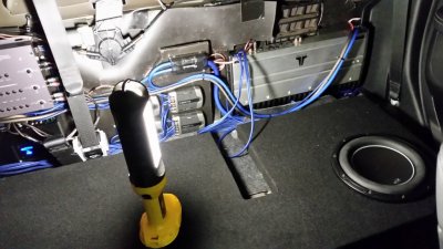

I put (2) JL 10W6V3's in my '14 Crewcab without having to raise the seats. Got an internal volume of 1.4 CF before adding the woofers. They sound incredible!
I had (2) 13w6's in my 2005 ram quadcab, but had to raise the seats 6". They sounded amazing, but the 10's are a perfect fit, and sound for my current rig. When the seat is flipped down, you'd never know they were there. Ive attached the only pic I can find on my PC, but will grab another when I get to the truck to show how its "hidden".
