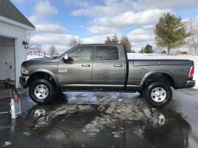

Here is my truck that I “leveled”. Still has about a 1 inch rake (higher in the back), which was my plan...cant stand when the ass end looks like its sagging.

That actually looks good. Yours is the first one I have seen that was done correctly, and I wouldn’t call that leveled. I am a master carpenter who can see things that are out of level at virtually any distance. Even with the shape of any truck on the market it’s not too hard to tell when the rear is shorter than the front regardless of actual measurements.

True. But thats the thing...if you actually measure it out and level it by measurement, it looks like the ass end is sagging. So whats really “level”? Personal preference, IMO.

Most leveling kits raise the front 2-2.5”, which levels the truck by the numbers, but also makes them appear nose high. Thats why I went with only 1.5”, which retained nearly 1” of rake. Looks perfect to me.
Oh it looks great. I agree with a tad bit of rake in a truck. Factory is entirely too much but I do like a little bit.
But yours isn’t the first I’ve seen. I think most that I see ratin .5-1” take most of the time.
