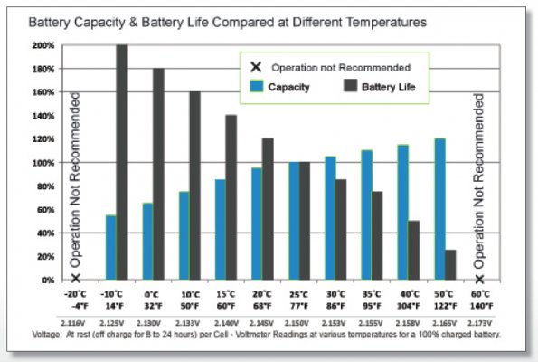

That is why I asked the second question as far as short trips, cold saves battery life but capacity goes the other way. As in short trips could cause this? At 44f you can see your capacity is in a state of drop. Of course as the hemi needs 790 cold crank amps, you can see how this can be the issue.
That is why I run 100% Synthetic Oil and a Battery with the biggest CCA I can fit! As you show Temps can make a big difference
