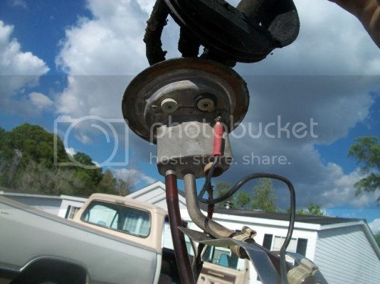

ok, so ive taken pretty much most of the truck apart to find out why this stupid gas guage isnt working, and so far its baffleing.... the floater is not stuck but ive found weird wiring, its cut up in four places, then one of the wires goes twords the backof the truck, is it supposed to go that way? i cant figure out whats live and whats not becuase the testing light wont light up for either wire

Only reason I could see a wire heading back would be for a ground???? Post up a pic of your pump and wiring.

ok, i got a few pics

Hmm.. i wonder if a few of those butt connectors aren't providing a good connection anymore?
