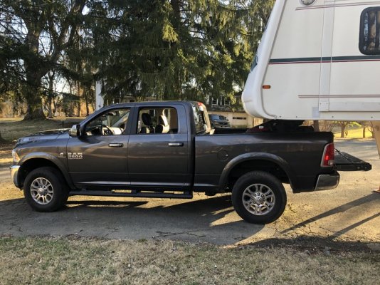

A few more things to consider. I finally loaded up my 2018 3500 and went to the scales with my 35 ft Fifth wheel. I had added up all the additional weight and thought I was good but when weighed I was 220 lbs over my rear axle rating (7,220 lbs, have a 7,000 lb axle) but good on the front axle (5080 lbs, has a 6,000 lb axle) and tires were good rated at 3,640 lbs ea. This also put me over my GVWR by 500 lbs. I then made a rack off rear of fifth wheel, relocated the generator that was in front compartment of RV to rear rack as well as the gas cans that were in bed of truck, moved the ice chest and other items from bed of truck to inside RV behind axle and weighed it again. I am now at 6860 lbs at rear and 5260 at front (still 320 lbs over GVWR of 11,800 lbs but good on both axles). I then realized my 90 gal fresh water tank (that was not filled during weighing) is located behind the rear axles of my RV. I filled the tank (adding approx 700 lbs to the trailer weight) trailer now weighed approx 15,000 lbs (truck rated to pull 24,646 lbs) but got my GVWR under the rating. Just get creative and redistribute the weight.
Additional info: 2018 Ram 3500 HO Diesel rated (by vin) Towing of 24,646 lbs and Payload of 3.860 lbs, Fifth Wheel Dry weight 12,400 lbs with hitch weight of 2,600 lbs.
when weighed had full tank of gas, myself, wife, dog and other misc in truck.
Shifting a lot of weight to behind the rear wheel of the trailer will impact the trailering characteristics and is generally not the answer to an overloaded truck. You're now going to have more opportunity to fishtail that rear end and be out of control. You should properly load the trailer just like you should properly load your truck. You need to keep all of your numbers, front and rear axle, payload, trailer axle weight, gross combined weight all within specs to be properly loaded. Anything else puts your family and others at risk. I haven't done any math on the numbers presented, just stating the basic physics of trailering here.

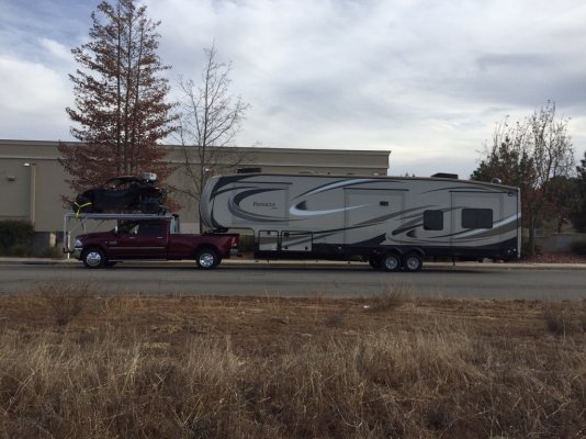

Don’t know what everyone’s qualifications are. I have held a class A license since 1997. I currently drive professionally. My wife and I own a 2016 3500 dually 4wd and a 2017 43’ Jaco 5th wheel. We have a 164FF655-2B35-4381-92C8-FCCA8A6E8BDE.jpegrack over the cab for our 2017 Maverick X3. We upgraded tires and wheels to g rated for the weight. The last time I scaled the rig it was 28,000 lbs. those who think gas over deisel are entitled to their opinion. Check out the full time RVers for the real story!
