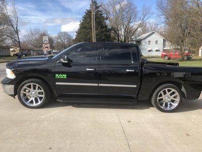

I have a 2014 ram 4x4 with belltech 2/4
I just had a alignment today.
They said I need adjustable a arms.
Jimmyzrx
Mar 9, 2019
Joplin Missouri
2006
Yes it seems to ride good
A little former but nothing like my 88 s15 back in the day lol.
I’m running 305/40/22 and all fits well together
