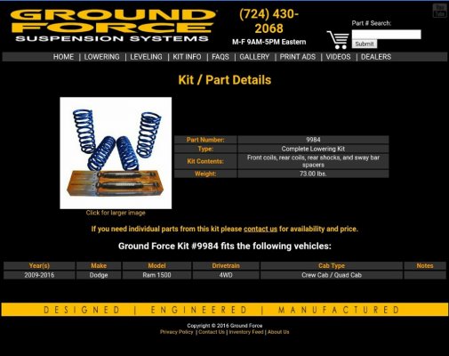

So got a question for u guys bought the Belltech suspension 2/4 drop go to have it installed can't. I have a 4x4 model that has a different front assembly. So before I return is it possible at all to make this work?

The rear will work just fine but you need either drop spindles or the Ground Force drop springs. Those are your only options for the 4wd.

Thats what i was told after, the tech originally said it worked. Then when I called again he said he miss spoke and hope I called back to clear it up. Yes the front set up is def different as already stated but can I use lowering springs with oem shocks to get desired drop.
Have anyone tried this?
Waiting on a call back from groundforce there kits is 4wd.4c9143df6baf0b3e0958a7c40be833f1.jpg
Sent from my SM-N920P using Tapatalk
That's their 4wd kit, I'm running the front springs from that kit in my quad cab.
