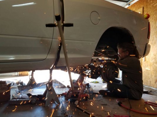

so what did you use to cut the rear top control arm support bracket?
A cutoff wheel and we just cut it up into sections until it was all off. Plasma cutter would be way better but wasn't an option.

yup I agree plasma cutter would be easier... I was thinking of buying a cheap one for $300 but don't know if I would ever use it again :shrug:

That's what craigslist is for...
But I hear the one harbor freight has actually isn't bad.. just not sure how long it lasts. I'm thinking of buying one also, but I will use the crap out of it... I have a tone of fab on may projects that I need to do and is hard to take to the farm shop all the time to do it.

I bought a plasma cutter when I was restoring a car and had a ton of sheet metal work to do. Got mine from Eastwood. It is flat out AWESOME and worth every penny! I highly recommend to anyone doing much metal cutting to add one to their arsenal. The time and effort it saves over a cut off wheel is insane.
