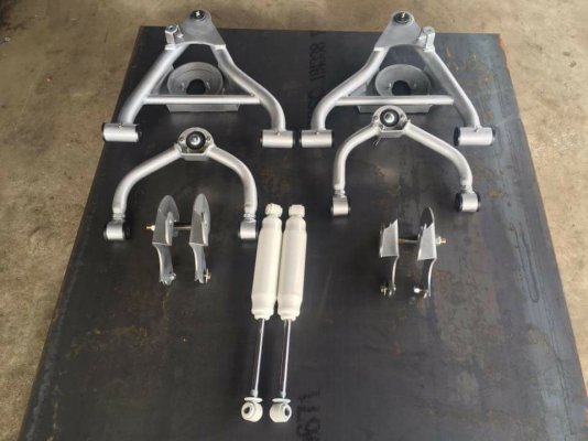

Here is the kit. Inez ships you control arms, rear brackets, rear shocks. Inez drop ships from bellwether rear springs, rear swaybar arms, and panhandle relocation bracket (also rear bump stops, but they aren't pictured).
You can cut the rear springs or not. If you don't it maintains factory rake but in a sporty lowered stance. If you do it's leveled.
Front is control arms only.

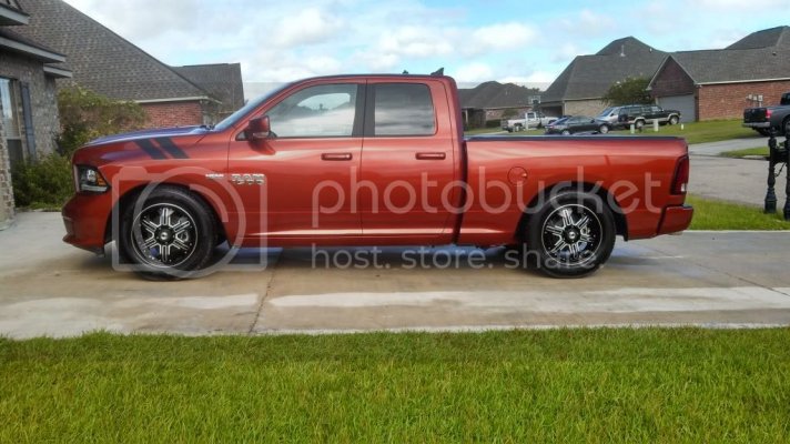

This was my 2013 Ram. It has a 4/5 drop on it. Included the McGaughy deluxe 2/4 drop with the addition of their 2" front drop springs and had the rears cut down another inch. Only thing I didn't have on it was the QA1 shocks. With the shocks, everything comes to $1280. The Inez kit would be $1870 and I'd have to still cut the rears and throw out the shock they sent.
Unless you are really looking for it with a tape measure, you can't tell the fronts stick out that much.
