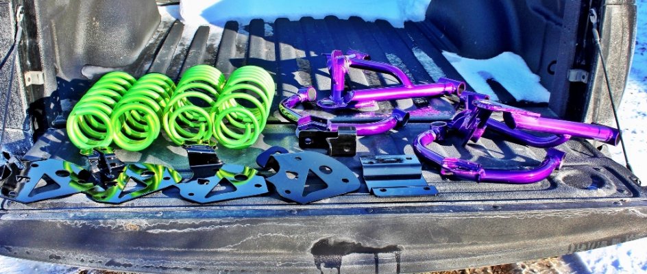

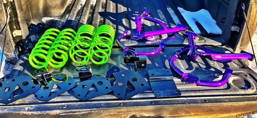

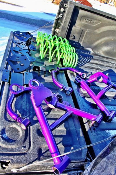

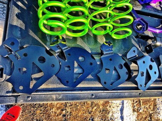

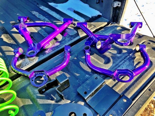

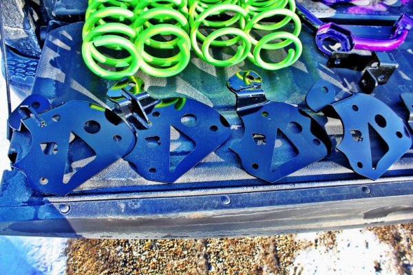

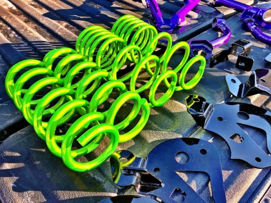

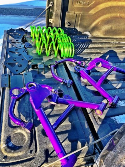

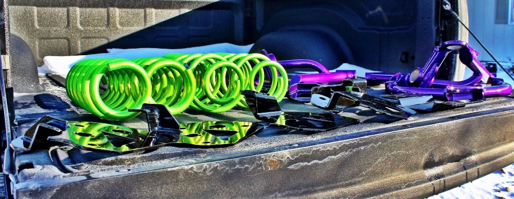

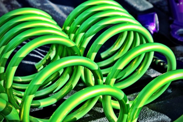

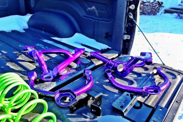

I got my parts back from powder coat....
The shocks and few other music pieces arrive beginning of the week, I’ll post pics. Then it’s going for install on 1/224a2947e2c2ec3e40a562154dc23e80d4.jpg54adbfb99d2a71897bd7212846388458.jpg283ba9845563fb12605f41e396e00b7a.jpg12e600e8ddcd9c3aeb95968ab0e8c556.jpg861ab580fefa115ec6055385e36a5767.jpg5489c6c977f11b7ca7f5761f4d51aa9d.jpg6d6f4ab2eff059b72baff1cfea537bfe.jpg45566889baf71cd4cf83c3cf32ba1e3a.jpg56b6c07cfee864e96edf8aaa3075233a.jpg02dca5c1195dc9aa4f9749bf0dac158a.jpg3b1eeffbbecc03a4a4b6e639e8656539.jpgc2168339891442f7cd7b68a31a090ec9.jpg0460ec064d7f90b20d6d467a857327fa.jpg
