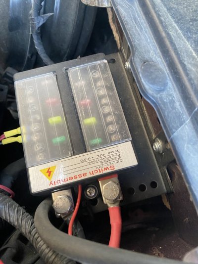

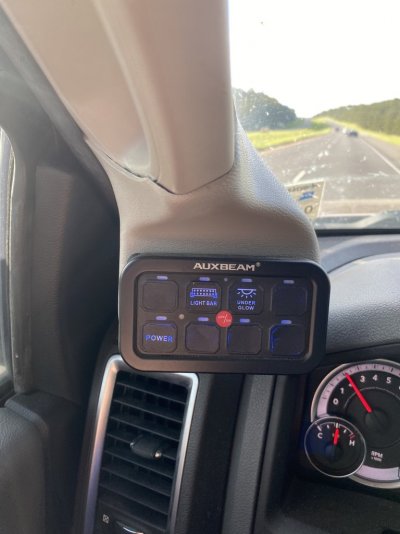

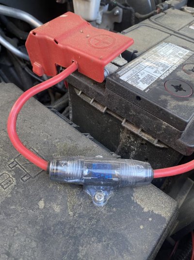

Hi I have 2022 ram 1500 I want to install dash cam but for the power I want to use one of the fuses which one should I use or are there I empty fuses I can use?
