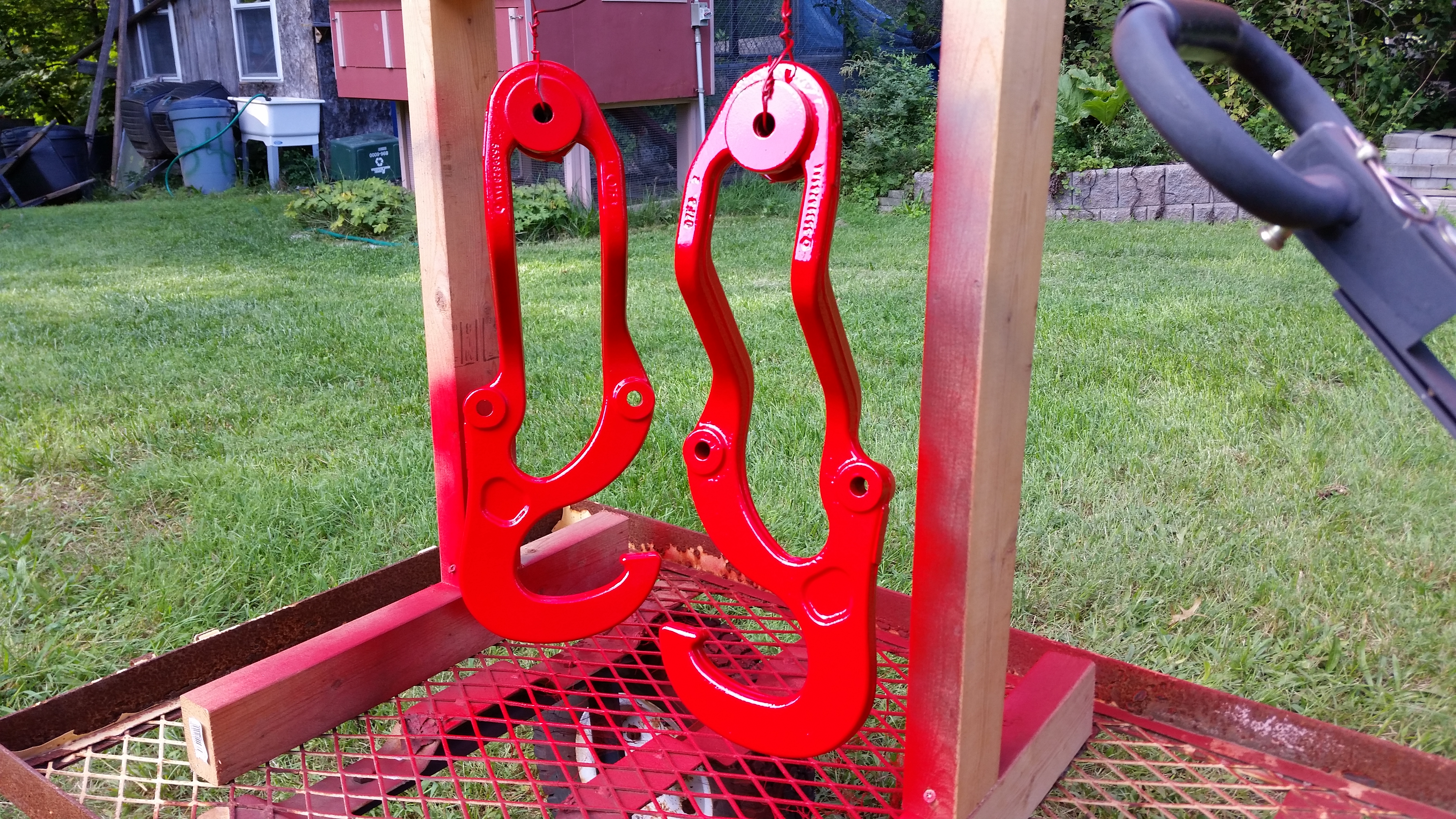

The weather has not been conducive to getting things painted here (almost non-stop rain) but we got some dry weather this weekend and I managed to get things painted. Next step is install of the brackets/hooks and cutting/fitting of the surround. We're forecast to get the remains of hurricane Florence tonight/tomorrow, so that's going to have to wait a few more days unfortunatly. Here's a couple of pics of things painted up to tide people over.

Do you remember what paint you used? The paint I got is red, but not bright red (has to much orange in it)
It was Rustoleum, I think it was Sunrise Red. I'll see if I still have the can in the garage. The hooks were used so I wire wheeled off some light rust & scuffed the remaining paint. Then applied a self etching primer and several coats of the paint.
