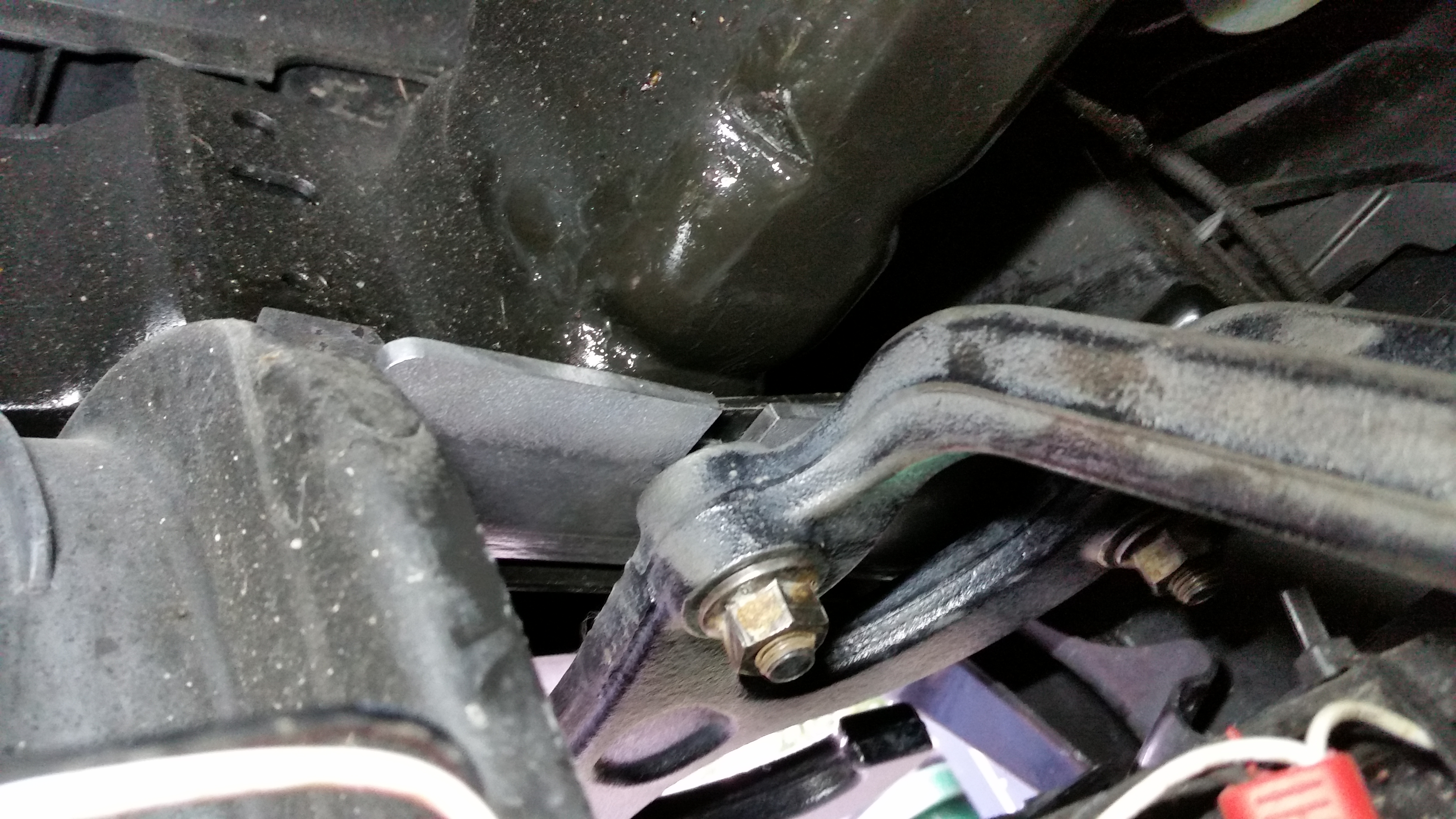

The color is Rustolium Professional Safety Red spray paint. I made the brackets myself out of 2"x2" angle mild steel. If you have a drill capable of the hole size needed and a jigsaw you can make them.

Any chance you would share the measurements or pattern, or a pic of what they look like installed from the underside so I can get an idea how they're set up?
As to the color, I'm still trying to decide if I want to use some of this brake caliper paint I have on hand, or have a local shop powder coat them for me. Either way, that red really looks sharp against the black truck.

They work just like the factory brackets, they just move the hooks over and up a bit.
This is from a test fit before things were painted. I've got the measurements around here somewhere, I'll see if I can find them.

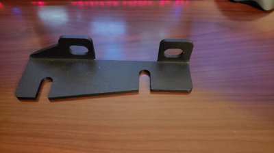

I'm looking to have a shop use the dimensions of the custom brackets and make me a set, for anyone who has done it, what material did make the bracket out of? Any specific types of steel better than others for this?

I know the last updates on this post is from last year, but has anyone come up with a source for these brackets. I have tow hooks installed on my 2013 Sport, but noticed that they are pushing down a fair amount on the bumper, and these custom brackets sure would help.

The plans are in this thread free to download I believe. If you take them to a properly equipped shop, they can fabricate them for you.
Honestly, I'm surprised a vendor hasn't picked these up to sell.

Sure wish you found a "pair" of them lying around. I'm checking with a friend of a friend to see if he make a set.

My gamble paid off, I just got a call last night from a friend that informed me that he made a set. Your welcome for the heads up. A win for both of us.

I found one bracket laying around anyone want it?
I can take this off your hands. I really wanted to get a set and am bummed I missed the bus on the set in the classifieds yesterday, but maybe I can take this to machine shop and have them duplicate it for the other side. I will DM you.
