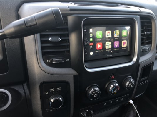

Installed a Sony XAV-AX100 in my truck
Jan 4, 2017
65
25
Cummins 6.7L
I’d been looking at various stereos to replace my 5.0 factory stereo with.... finally decided on this AX-100 unit.
It took right at an hour to install. I did not have to cut the factory bracket, as the single-din chassis slid right into the opening in the bracket.
I ordered it from crutchfield; the stereo was $328, and with the harness, double din kit, and USB port, I spent about $420..... edit to add; there was also an antenna adapter, and I paid extra for quick shipping so I would have it to install last night. So probably would’ve been about $390 with the free shipping.
Some other notes: the harness came with a small speaker for chimes, but I still have factory door chimes. I’m not sure but I think maybe the reverse warning sensor is coming through that speaker.
I disabled the reverse guidelines on the Sony unit as I still have the factory reverse guidelines overlaid on the screen. I’m also very happy with the reverse camera image quality. I was worried the image quality wouldn’t be great once the image was displayed on the larger screen, but I would say it is excellent.
The sound quality, compared to the factory radio, is much better. I’m actually surprised at just how much better the factory speakers sound with this unit.
Maps switch from day to night mode based on the headlights being off or on; that’s nice.
I was able to get the external microphone cable routed to the top of my A-pillar without removing the pillar; I peeled back the door seal and got the cable just up under the edge of the pillar. You can’t see the cable at all. The call quality through CarPlay is much, much better than the uconnect Bluetooth.
I ordered a USB port with a 5’ cable and installed it in place of the 12v outlet. I used the factory housing with the lid; it’s not perfect as it doesn’t quite lock in to that hole, so I will need to glue it down. I’m still thinking about routing it to my jump seat console.
The only thing I would complain about is the stiffness of the volume knob; it’s not easy to get your fingers around it so you have to roll your fingers around the edge of it. It’d be easier if it weren’t quite so stiff.
Some other issues not related to this radio; the SiriusXM app is bad, and Pandora is bad. They sometimes fail to load. I may regret not getting the AX-200 with an XM tuner, but I’ve got 30 days to think that over. The sound quality through the XM app is so much better than the compressed XM tuner though so maybe I can learn to live with it. I’ve been an XM subscriber since 2005, and it’s not something I want to give up. I spend a lot of time in my truck traveling around to various job sites, and it’s what I mostly listen to.
Also, the fit of the double din kit isn’t perfect. There is a slight gap at the bottom and while it’s not easily noticeable, it bothers me.
Other than that, this seems to be an excellent stereo. One other feature I like is that you can turn the screen off while the unit is on.

Looks good! Nice info!
Thanks! These were all questions I had myself about it that I was unable to find answers to online, so I hope it will be useful info to someone else.
