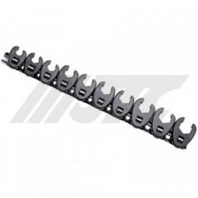

pleaassssseeeee let me know after installation ) BTW, don't forget about such a tool for
key nakidnoy.jpgtop shock mount, or any other very short whrench. Otherwise you will not loosenkey nakidnoy.jpg the nut...
View attachment 186534top shock mount, or any other very short whrench. Otherwise you will not loosenView attachment 186534 the nut...
I just got a spare 19mm wrench and cut it in half. Makes life a lot easier.
