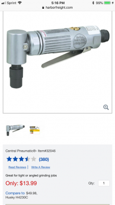

If you have access to an electric burr grinder, or a 90 degree air burr grinder with a barrel bit you can hog out the metal really easily.
$14 at harbor junk. From shat i heard, template that comes with the speaker only measures 3 3/4” for the hole that needs to be cut. Factory dash speakers are 3 1/2” so not much metal needs to be removed. Barrel burr bits are pricey though.

A dremel has a straight shaft, and will be difficult to get it in there. Hence why i mentioned the cheap harbor junk air burr grinder with a 90 degree head.
If you do use a dremel, you will beed to use a burr bit. You would be there for years with a sanding bit.
