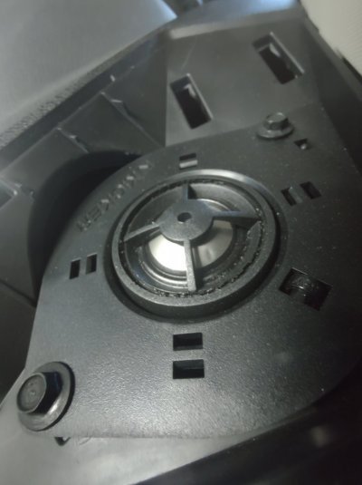

The original factory 3.5" dash speakers and the ones in the 77KICK28ab are actually a tweeter as they have a crossover on them. If you put a full range 3.5" speaker, you'll probably need to use a 4 ohm resistor in line with them as you may find them overwhelming.
I'll second going with the Mopar Kicker upgrade speakers, they make a huge difference and sound good.
The Mopar Kicker dash "tweeter"
Thanks for the info. My concern was actually that the tweeter wouldn't provide "enough" when compared to a 3.5". It seems most people are happy with the sound. I'll likely be going with the mopar kit as i'd prefer to avoid adding in resistors (i believe it's relatively simple, but I've never done it before).
