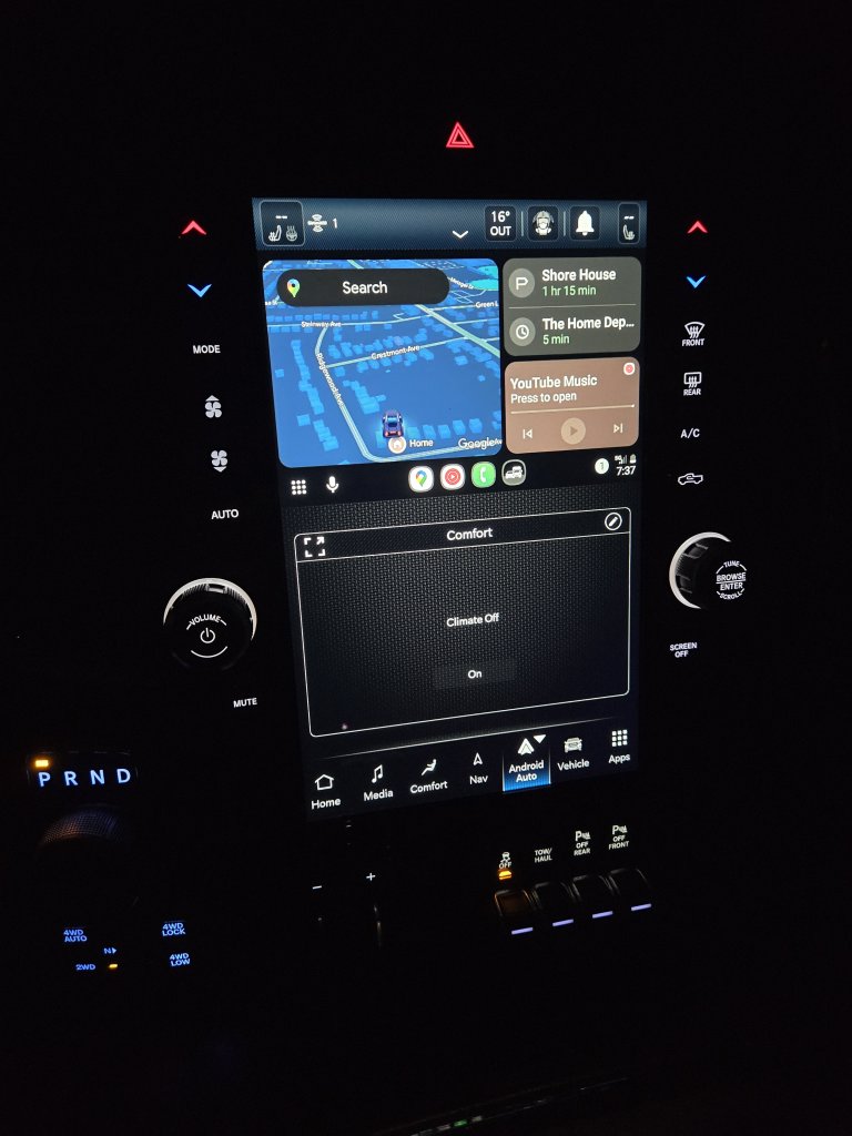

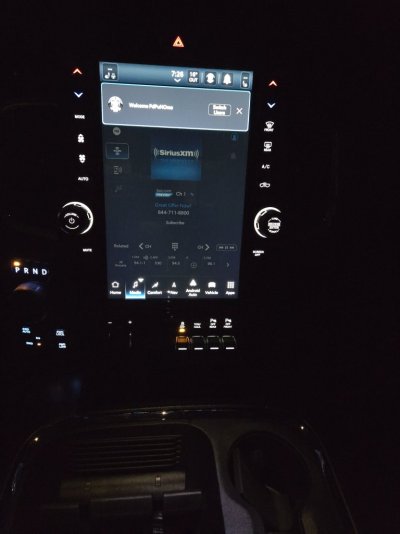

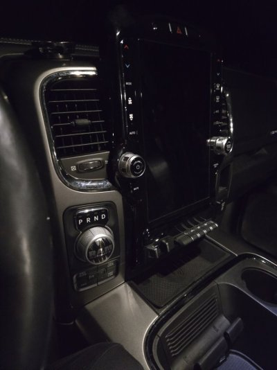

Few pics, got it mounted in. I repined the cargo camera from 24,25,26 to 21,22,23 but the radio is still not recognizing it at all, so other than that everything is working besides the climate physical buttons. I did notice that for my heated seats, heated steering wheel and vented seats the on-screen controls are greyed out/inactive when the engine is not running, this was not the case with the UAQ, UAS, VP3 or VP4. Not a big deal but did like to have those running even when engine off so I will just have to get used to that. It is not a perfect look fit wise by any means, very crude but the tradeoff surpasses that by a mile.
I will also say very disappointed in the android auto display as it is tiny even smaller than on the 8.4 UAQ or newer. I have the 10.1 screen in my Durango and aa is full screen, so that may sway me to swap out as I have both android for personal and an apple for work which I use android auto primarily over CarPlay for a much better navigation experience driving half the country for work all the time. I point that out, because it is very noticeable how small aa is on this. Apple carplay is full screen and you can have both phones connected at the same time and quickly toggle between the two.

If you tap the map in AA it should go half screen. You can make the display a little better with AAWireless to control DPI and noble the icon bar to the left instead of the bottom of the screen.
