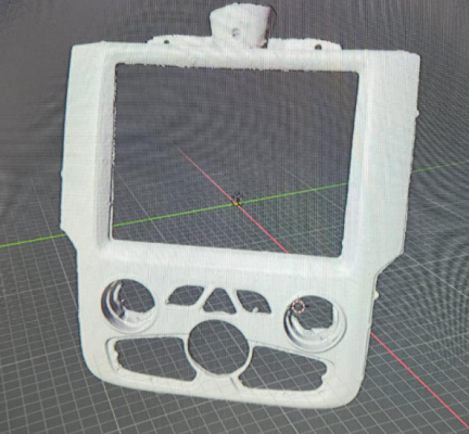

That's how it started but getting a good scan has been problematic... @reyokonova can expand more on this as he has spearheaded the design effort.
its hard to tell from this but the surface has alot of imperfections and the scan dots show up so if i was to print this it would have little round bumps all over it you can see them on the edges actually.

yes that was the original plan but thats outside my skill level i have the scan of the oem bezel if you want it but i need somone better with 3d cad to clean it up i have 2 friends working on it as a side porject right now and i have to send the bezel you sent me to him so he can take measurements of it once i have a cleaned up scan then i cam merge this into it esentially and we will have it to counter sink it im fairly certian will require to mod the upper dash with a few cuts i had cut mine but @SitKneelBend was able to to make a few changes to my kit and make it fit without cutting anything for this version of the bezel ill add his changes to the 3d files as soon as i can.
I got to shimmying things around a bit and I think there's a good argument for moving the entire screen up a tiny bit (to be able to unplug the LVDS more easily without straining the connection on the board) but I love this design. A full bezel integration would be pretty cool though.

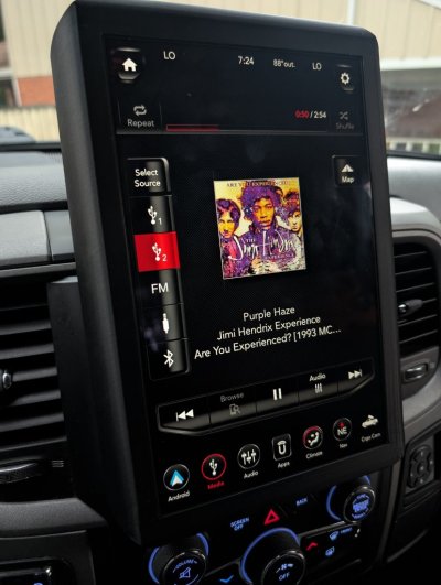

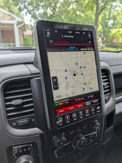

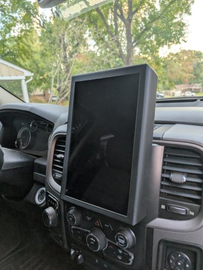

Here's my latest iteration building on @reyokonova 's 12.1" UAX model. I'm loving this 3D printing thing!PXL_20250720_152130260.jpg

Tweaked the front bezel more and used a newish product to print it (polymaker HT-PLA). It looks great against the dash, we'll see how it holds up!

PETG is probably the way to go here for longevity but that looks great as is!

The first few were all PETG but polymaker recently came out with a high temperature PLA and it prints amazing. The support brackets behind are still PETG though. I'm pretty stoked to see how this HT-PLA performs. Check out the videos on YouTube...

That looks awesome

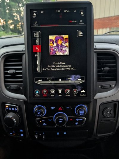

Thanks! We are still tweaking some things but this setup is pretty freaking cool. Some might think it sits too high but when you see it in person it feels like the ideal placement for the radio IMO...

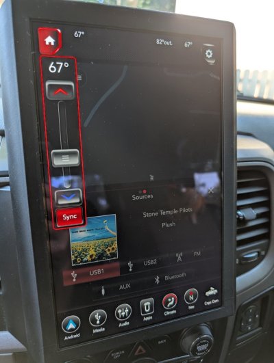

Couple updates, I used @Mpgrimm2 's/M2Mods 8.4 ATC conversion harness and the required sensors (humidity sensor gifted by @reyokonova with a custom 3D printed mount :) ) and activated Single zone ATC on my 2014 Express with the 12.1" UAX installed. So far as I can see everything works but I'm continuing to test...

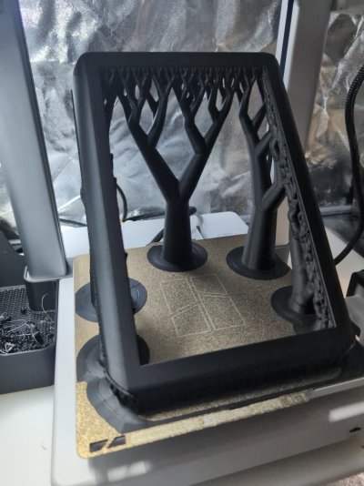

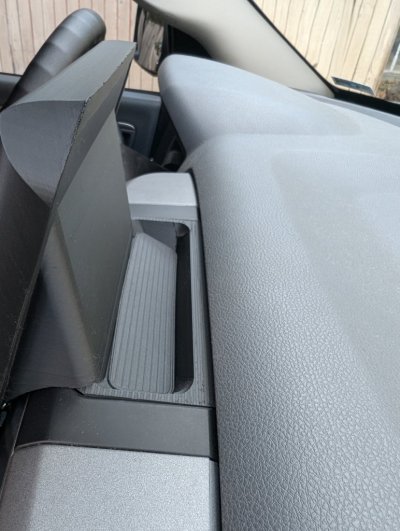

Almost perfect now. If I ever get my hands on an 8.4 or RA2 detailed scan of the bezel (preferably without the knobs), we can make this really perfect. One of the biggest challenges of integrating a screen into a bezel is the print volume needs to be very large. My 256x256 printer is at its max printing at a 45 degree angle for the screen bezel. As of now, this can be done without cutting any factory parts.

Looking like factory man !!
Awesome job if I didn’t have my setup I would be after this setup in a heart beat looks great !!
Thanks! Also thanks for answering my questions early on!
