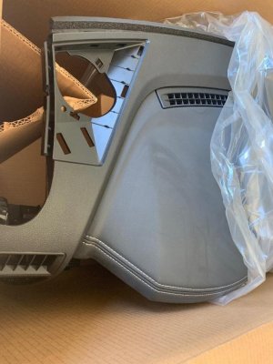

Got a new leather dash to replace the factory grey plastic one in my 17 Ram. Has anyone done this? Any helpful advise before I get started? I just want to do this once the right way. :)

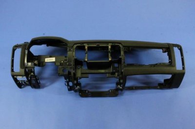

My advice is to pull the entire dash from the truck. Does the new pad have a air bag "holder" welded to the back of the passenger side? Is the sunlight sensor already mounted? Those 2 things that usually go on a dash pad. The other is it will probably have a bunch of clips holding it all together.
The new pad has no metal frame on the inside, will reuse the one that is in the truck now. Also there are no part on the new pad, no grills, no sensors.

I don't know about how the airbag is attached in the Ram. In A Chevy Malibu the plastic bracket that holds the airbag in place is vibrating welded to the back of the pad after the pad has been laser scored to 1/2 it's depth so when it deploys it can break through. all the grills and senors mount to the pad before getting mounted to the entire assembly.

I got the matching Sport center bezel, console bezel and chrome side vents. Ordered all from a vin number for a 18 Ram Sport. Should look like it all came from the factory new.
