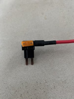

I'm getting ready to install some mopar cab lights on my 1500. Gonna have to run my power wire down to the fuse box and use a fuse tap. The location is F79 and is occupied by a 15 amp fuse. Am I going to need to add a fuse to the tap (meaning it would have 2 fuses) and if so, what amp fuse do you think?

UPDATE: Nothing drilled or installed yet. I've tested the whole light and harness assembly to make sure it works. Using the Auxito LEDs from amazon that most are running.
1. When lead and ground are connected to the battery = lights come on
2. Added fuse tap with 5 amp fuse on top. lead and ground to battery = lights come on
3. Tested fuse F79 (15 amp, for clearance lights). Lights off = no power. Lights on = power
4. Inserted fuse tap. 15 amp on bottom, 5 on top. Grounded to bolt in next to tipm = no lights. Rub ground on (-) battery terminal = lights dimly flicker
I'm not really sure what I'm doing wrong but if anyone had some thoughts they would be appreciated

F79 is hot when the headlights are on. My fuse tap has 5 amp fuse, and I put the original 15 amp in the bottom slot.
Aside from not tapping into the harness down the A pillar like on 2500/3500, I believe the fuse tap in F79 is what most have done. My question is what am i doing wrong? Maybe a bad ground spot? but i was grounded to where another ground wire is..

When adding(tapping) a circuit you should always fuse it. Usually LEDs come on 2 flavors 3w or 5w. Using 5 5w bulbs, that 25w. Amps=watts/volts. 25w/12v=2.083amps
Rub ground on (-) battery terminal = lights dimly flicker, that is pointing to the wiring. With the ground disconnected, measure the voltage at the end of the ground wire with the red lead on the ground wire and the black lead on the neg. battery post.
And for S&Gs once all figured out, turn the lights off and leave the meter in the middle (completing the circuit) and put the meter on amps. The turn the lights on, this will give you a reading of the amp draw. You can use this to see if 3 5w bulbs. Alot of times this is the difference between regular and "Super Bright" LEDs.

I've used a multi meter on the 15 amp fuse in F79 by itself and while having the tap wired in, all good both ways. However, with the tap in place the 5 amp fuse has no power.. But if I put the wires on the + and - terminals of the battery (power going through the tap) the lights come on

Is it possible that the wiring harness itself could be backwards?
My truck doesn't have the red shroud over the + battery terminal. I'm seeing another truck that is making me to believe the only way I was getting the lights on was by putting my green lead and fused wire to the - terminal and the ring ground wire on the + terminal. Meanwhile, while I was doing it, I was thinking it was lead to + and ground to -
To test this theory (because we just got 18" of snow), I grabbed a 24v drill battery. Again, the lights only come on when the ringed ground wire is in the + and the fused lead wire in the -

Anything is possible, but I doubt it. So what your saying is you can "fuse" the green ground wire to power, and put the power wire to ground and the lights work ? And this is a Mopar cab light kit ? Being a Mopar cab light kit, my green ring terminal was the ground, and the other wire was the power.

I wish I could remember on my kit, but I thought the ground ring terminal was on the green ? By any chance did you add the ring terminal onto the black wire ? The other thing I noticed, are the bulbs LED ?

I'll see if I can find my original install sheet later and see if there is info on that. If those are LED's, some are polarity sensitive and you could try turning them 180 degrees and see if that works.

Wow! You're the man! I had all the polarities the same way but backwards, so the lights all came on with my wiring backwards. Now that I switched them around, they come on with the green with to the positive and the black to the negative. I am 1000% certain these with work tapped into F79 now. Thank you, thank you, thank you!
