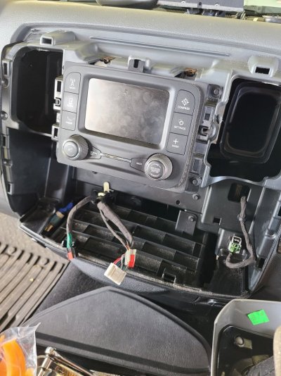

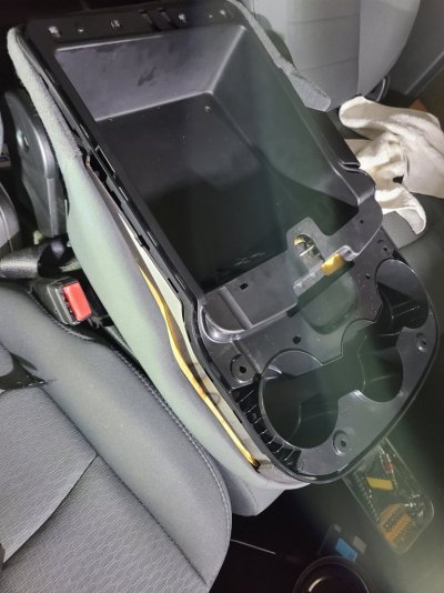

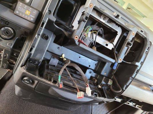

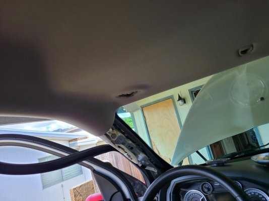

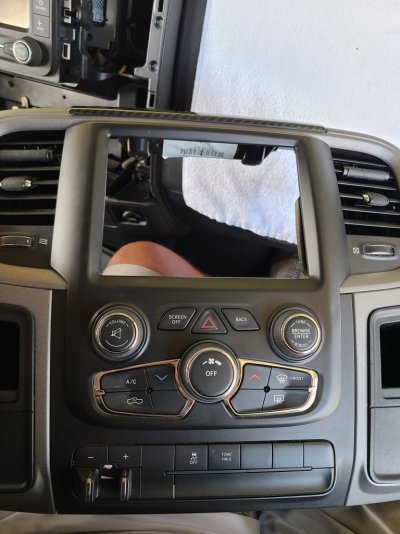

I can tell you from personal experience...I have a 2014 Ram Express, and I did the swap from the stock 5.0 to a My18 UAQ 8.4 Nav/CarPlay/AA unit and it was the best thing I could've done 100%. I saved a TON of money by sourcing out the parts myself; I found a used UAQ 8.4 for $800 shipped (to Hawaii, which always costs more!) and all the parts I needed for the conversion were purchased from @Mpgrimm2 (M2mods) right here from this Forum. He (in my opinion) is the expert in this conversion, and helped me out every step of the way. With his research, he's mastered all the little nuances involved in doing the conversion (where others had failed, even Infotainment...who eventually mimicked his designs). Too many details to get into, but believe me, its been a lifesaver. I love my UAQ and use Android Auto religiously. I am by no means a mechanic or technician...and as complicated as the swap seemed, I was able to do it with confidence. In order to get everything to work correctly, there are alot of steps; harnesses, sensors, conversion plugs, a/c bezel (for touchscreen climate controls), a new media hub (6-wire to 8-wire), and of course, the AlfaOBD steps. After the swap, I upgraded my 6-speaker system to Infinity Reference and I've been lovin it ever since. I also have the center seat/console, and swapping out the media hub was easy; a dremel tool to trim out the hole to snap in the new one. Reach out to @Mpgrimm2 and you won't be disappointed...I'll attach some photos to show some of the process.
