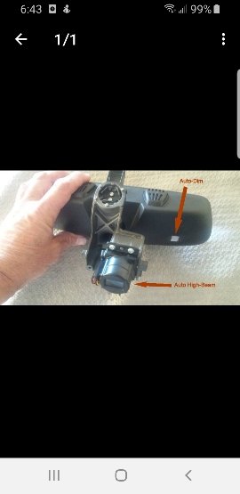

Are you sure you have an auto high beam mirror? They are listed incorrectly all the time. For a guide to enable the correct mirror codes refer to the first post in the Alfa thread under (Known Working Codes) and follow the directions there. This is a pic of an Auto Dim/Auto High Beam mirror. If you don't have the camera looking lens like the one in the pic it's not an Auto Dim/Auto High Beam mirror it's just a standard Auto Dim mirror which is also fine. Since you have the RA2 radio the soft button to turn the Auto Dim on and off may not appear like it does on the RA3 and RA4 8.4" radios but it should turn on by default. 5b23157ea6802531b5e5d743d40d5ded.jpg
I have the auto dim mirror only.
