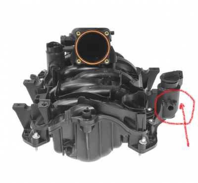

I'm leery of the Dormans, they seems to function well enough but I saw one where they didn't copy the oil fill and vent tube correctly on the LX version and every time the guy put oil in he ended up filling his air filter box. They're not quite exactly the same.
Stock
Screenshot_2020-06-17 2004 05 06 07 08 DODGE RAM 1500 2500 RAM DURANGO 5 7L Hemi Intake Manifold.png
Dorman
It would seem they did the same thing with the Ram manifold.
