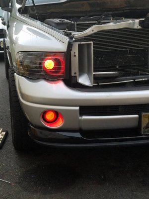

here are some pics of my truck. to the right of the pass headlight is my airram jet scoop. above my license plate hard to see in this pic is the vararam bumper scoop its behind my lower grille painted silver too.

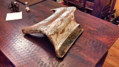

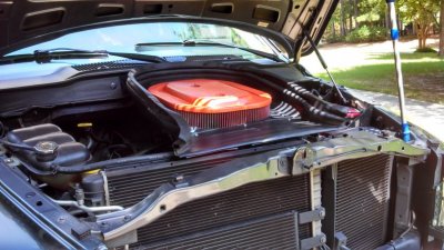

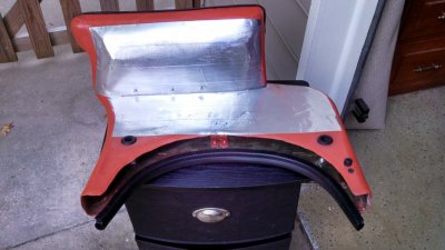

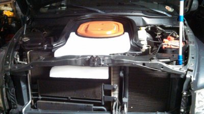

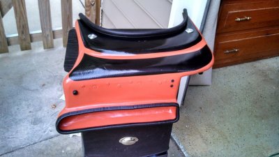

Not really a step by step, but I adapted a 4th gen Vararam to my 3rd gen by making a 90 degree coupling that would go around my AC lines. I first had to relocate the overflow tank. I made the scoop using what's called the "lost foam method". I made a foam template first then covered it packing tape. Then I epoxy coated it and after it cured I fiber glassed it, then melted the foam out with lacquer thinner. It's very strong, yet pliable for engine movement. I painted it and used "Quick Latches" push button type to attach it to the pan, everything can come off, including the base pan in 10min or less. The scoop just unlatches and slips out. Here are the steps in photos.
