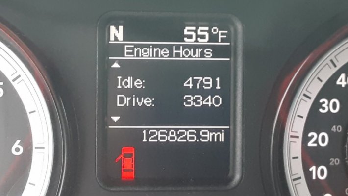

BadHemi2014
Feb 7, 2020
942
1,730
Greater Cincinnati area
Wow! 4700+ in just idle hours? How many total hours on that beast? To me, that's an amazing endurance test right there. Totally OT, but does yours have the 8 or 6spd trans?
My 2019 classic, hemi is currently at exactly 70 idle time hours and 900 total hours at 42500mi. I bought mine in July 2020 as an ex-rental w/ 15K miles on it. The idle time hours were right around 70 when I got it. I never idle the thing and my driving is basically zero stop/go and all highway.
It has the 6 speed, 65RFE.
Here's the total hours and miles as of today:
I figure it idled around 4 hours a day, 5 days a wk, for the 4 years or so that the company owned it, just a rough guess based on the idle hours.
I probably would have passed it up if I'd known to look at this screen before I bought it! Oh well, it will be freshly rebuilt with cam and nonMDS lifters and hopefully last another 100K.
"Cheaper to keep 'er!" :Big Laugh:
