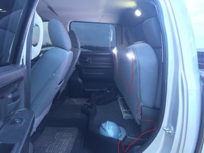

I just tapped into the front footwell light. I couldn't find the wire that runs to the rear dome light so I ran a wire under the doorsills up to under the steering wheel and tapped into the stock footwell light wire there. (I did the OEM footwell lighting installation mod) I've never had a problem with t-taps.

That's cool! Was it a pain in the a** to run the wires through the seats? Or, do you have them hidden somewhere else? Pretty clever the way you did that.

It was kinda tough getting the LED strips up and through the small slits I made in the bottom of the seat cover. Once I got them through I just ran the wire down towards the back in the drivers side corner and then under the fabric on the bottom of the storage area. I went down to the bottom (where the hard hat is) and up and over the lip and down into the door sill. I tried to illustrate how I ran the wires in the picture.
