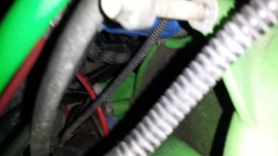

Hey yall. I have a 2000 ram 1500 5.9l. I have a issue that's stumping me. The truck runs amazingly.. but SOMETIMES at low ram at idol.. it kinda starts to bog down and stall out unless I stop it by giving it gas.. if I put it in neutral while it's doing it; it comes back to higher rpm for a short time and does it again.. I have replaced the plugs, wires, cap and rotor.. TPS and Idle air control valve, cleaned the throttle body (only what i can get to without taking it all the way off). THEN I found a vaccum leak.. it's some sort of port (nipple shaped) device that sucks air. It's located right under my Transmission dip stick but have no idea where it connects to.. I taped it up and the truck is still having the issue. Thanks for reading. If you have any questions I will answer them fully.

These pictures are BEFORE I taped it up so you can see what it is.. thanks for reading.

These pics show the vacuum line you're talking about. $10 says you don't have 4x4 right now because that line goes to the vacuum switch on top of the tcase.
