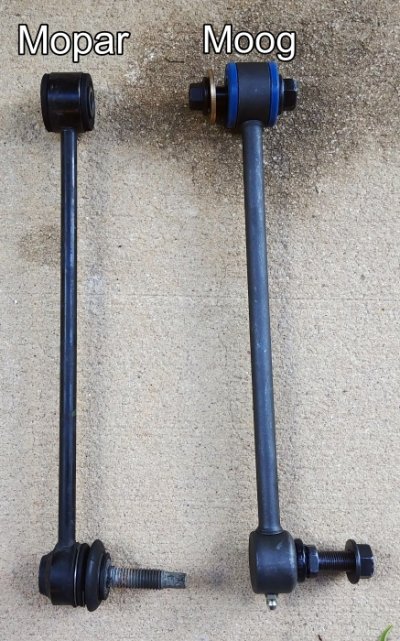

My front and rear sway bar bushings are shot so I’m wondering if there are any aftermarket sway bar bushings, links, or sway bars that are worth getting?
Are factory bushings preferred?
Besides Hellwig rear sway bars, are there any other rear or front bars worth upgrading to?
I have a pair of Suspension Maxx extended front links already, though I need to see if I can RMA one of them since its lower stud sheared off well before 50 ft-lbs for some reason. Rear links are whatever came with my Zone lift.

Core 4x4 rear end links in whatever length you need and call it a day.
Core makes rear links too? Nice. I'll swap over to those for sure. Been planning to do the control arms and panhard from them as well.

This is why I'm a bit concerned about the Zone rear end links, they are exposed stainless steel and it's winter time here... Not sure if they will even last the winter.
