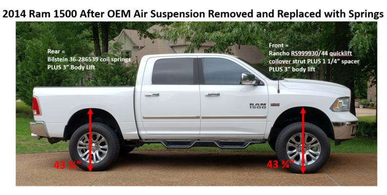

I finally did it! After repeated failures with my OEM air suspension, I had enough and removed it and replaced it with coilovers in front and coil springs in the rear.
The entire job took only 5 hours and I am very happy with the results. No more sagging, intermittent let down etc.. She stands tall and firm and I wish I would have done this months ago
My parts list is:
Rear coil spring - Bilstein 36-286539 (comes as a pair)
Rear coil spring isolator - MOPAR 2855789AB (2)
Front coilover struts - Rancho RS999930 & RS999944 (one PN is left, the other is right)
I also added a front 1 1/4" spacer to level the truck (already had the spacer)

Jelyse, your questions are spot on.
Let me answer your questions like this:
1. Ride comparison - no spring setup will match the smoothness of air ride (period...end of report), which is why 'air ride' is a premium option and costs a pretty penny.
2. Reliability - air ride will fail. Not an issue of "IF", but "WHEN" and the "WHEN" is very frustrating. I kept an air nipple in my truck to add compressed air to my system when needed
3. The Rancho coilovers in the front allow me to set the front as firm or soft as I want which is really nice
4. The Bilstein coils in the rear are fine. Nothing special about them, but they are 1" oversized
I have not towed anything since I swapped the air ride for coilovers, but I have had several loads of sand and/or mulch (1 yard at a time) in my truck with no problems. Yes, the truck will ride low in the rear without air suspension, but it doesn't bottom out on the bump stops anymore :).
- Am I glad I replaced the air ride with coilovers? ABSOLUTELY
- Is the coilover suspension as soft as air ride? NOPE...but not far from it. I'm pleased with it.
- If I had to do it over, would I change anything? Perhaps...I may swap my rear Bilstein 4600 shocks for Rancho adjustables to allow me to firm up the rear like the front. But that is the only thing I would change.
The air ride just had too many issues that kept popping up and the cost to fix it was too high. I no longer have to worry about my suspension dropping on the bumpstops!!!!!!!!!!
