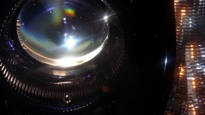

Someone i was talking to said my lights look melted. Is this true or a problem, im clueless on this matter so i dont know if its true. Pic is from tonight so probably not best angle.

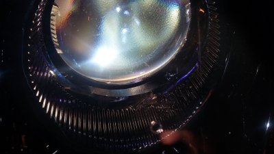

more pics
1 2 3

My understanding is that is a common problem with projectors but does not get any worse. Something to do with the lens and concentrated light reflection causing a slight magnification burn of the interior clear plastic outer cover.
You could probably get a warranty replacement but the next set will do the same thing eventually.

Common problem, just had mine replaced under warranty with chrome ones, blacks are discontinued, they was they were painted with the defect from factory haa nothing to do with heat or sun damaged. I raised the roof with dealer and they gave me back my black ones and i sold them locally for $600.00 cash

Maybe left overs but rest asured you wont get replacement black ones, i faught chrysler canada for them and lost, all the new rebels are suppose to have black out headlights and there being shipped with chrome now also
