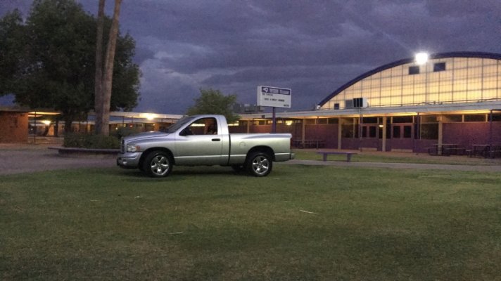

Yeah 33s should fit. Just watch the tire section width. Look at the distance between you current tire and your upper control arm. Your current tires are just about 33s, and if you go with 285s you should be okay. 33/12.50s might be too wide with stock rims. I'm unsure of the leveling kit though. I don't know too much about 2wd stuff.

Yeah I'm not sure on the back spacing of my stock rims now so I think that's the only thing I'm worried about

Can anyone tell me if they are good quality or not?

Would kinda suggest gettin either the maxtrac or rough country coil spring not spacer some of the guys have said that their ride quality was bad after the spacer. Plus the coil is gonna be sitting in the bucket properly where that'll push it down
