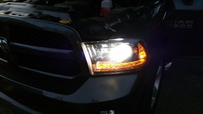

So I noticed tonight that my passenger side projector lamp did not have the yellow/orange running led lights on. You can see the difference in the attached pics. I have the retro shop adapter harness as my Ram came with the standard reflector lights. I checked all the connections and everything was tight. I'm at a loss because they still blink when I click the turn signal on.. just not on all the time like the driver side.
Any ideas?

i had the exact issue. You need to take the head light out and check the metal pins on the adapter, make sure non are bent when you connect it to the headlight. Im sure this is your problem , it was mine.

And tada! Not only was a pin bent.. it was corroded pretty bad.. at this point I'm putting my OEM lights back in.. I don't need a faulty harness frying my factory wires.. Look for these Projectors to be for sale soon With the moriomoto HID kit.. the retro shop harness is going in the trash..

Yeah.. where the retro shop harness connects to the OEM harness it was corroded like an old battery. Not bad, but it could of gotten worse. The other side that was working had started to corrode a bit too.. don't know if it was the high power draw of the HID's or what, but I'm leaving it stock now. Seen plenty of burned up wires from bad light installs and I don't wanna end up being one of them.
After fixing the bent pin, the projector was working correctly though.
