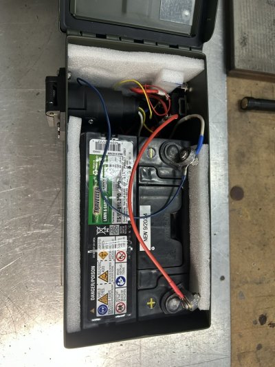

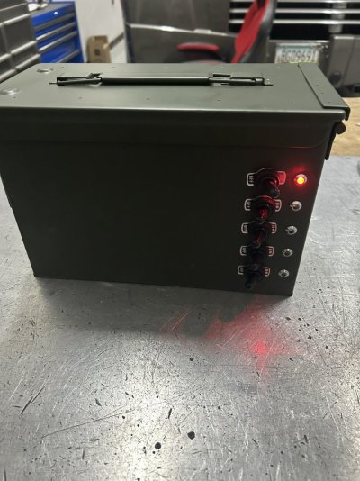

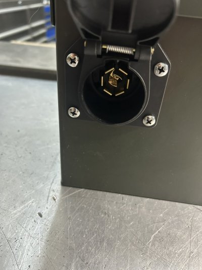

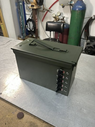

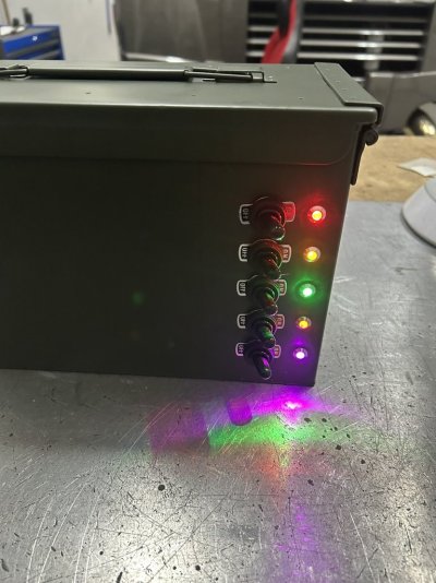

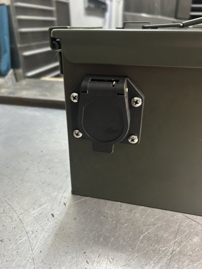

Not that this would help the OP at present, or anyone else, I finally built my new little toy/tool that really helps with both the new wiring of a trailer/toad (vehicle towed behind an RV) and the occasional testing of existing wiring of all trailers and toads with a 7-pin connector. It's simply a box with a 12V battery in it and it's wired through a set of toggle switches to the 7-pin female (truck/RV side) female connector. When I want to check either of the vehicles we tow, the Ram or, our '15 Jeep JKUR Rubicon, or, our Bennington Tri-toon boat trailer's lights, I simply carry the box, which is nothing but a small Harbor Freight Ammo box, over to the receptacle for any of those three and plug in the box to it. Then, I begin flipping the switches, one by one, to send power to what ever circuit I want to test, running, right turn, left turn, Brakes and even 12V power if it's equipped. It just makes insuring that all trailer/toad lights are working correctly WITHOUT using any of the vehicles as power to test the systems.

I have wired several trailers and they all work fine when plugged into my Ram's 7-way. But then I have never used the aux pin. Is that the issue?
FIREUP, your test box is genius if you do a lot of trailer wiring work.

Guitar Guy,
I thank you for the nice comment. I don't do a "lot" of trailer work, just some once in a while. I had that 12V battery hanging around for testing LED's and stuff that I have a hobby in. I figured, heck, why not use that battery and get a little box from H/F and see if I can build one of those testers. it took me about a day to build and it was a fun project. I've since installed an SAE (2-pin plug) on it for when I want to acquire power for my testing of my LED projects.
