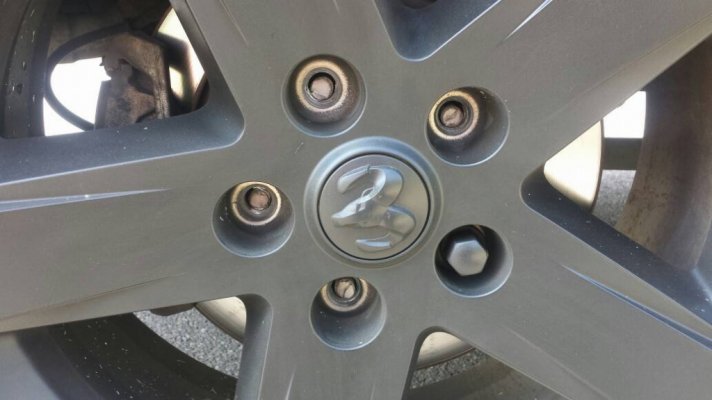

Don't do it or this will happen....
P.S. I had the correct lug nuts... but the "trained tech" at my local Ram Dealership f**ked up bad and the result was this.

You absolutely do not use 9/16 x 18" lug nuts on 14 x 1.5mm studs.
Like the pictures show, you will snap off the studs. The stress you would put on those studs would be unbelievable! ( I think to myself: how could anyone even imagine doing that! )
