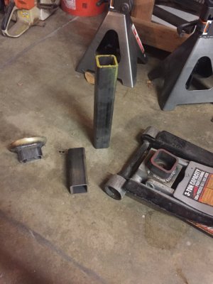

If you are looking for home use there are a couple of other option. I have them all or have made them and they work out well for me
1. is a jack stand with a built in jacks that can be bought at tractor supply https://www.amazon.com/dp/B003ULZGF...K0&pd_rd_r=GGM8AC759WKJ4SYT3AJX&pd_rd_w=BDlPJ
2. block as someone else mentioned
3. jack extension, can be welded up yourself or purchased
https://www.amazon.com/Champ-Floor-Jack-Height-Extender-5/dp/B00CM9ZHOQ
Depending on what I'm working on I tend to use the bottle jack jackstand often with cribbing under it to set it up to have to run the jack out as little as needed.
