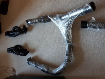

JBA & AFE Y-Pipe back from ceramic coating.

I had the exhaust put on today, I must say it sounds nice.
JBA shorties hooked up into an AFE Y-pipe into stock muffler with some MOES 5 inch tips.
There is a noticable increse in power and acceleration. Has a nice rumble to it and i dont have that annoying TICKING sound from the broken bolts anymore.
Gary's Hemi

So the AFE y pipe fits good huh? I have been looking at it here & there

I didn't even realize someone made a catless Y pipe for our trucks that wasn't for long tubes. Very awesome.

If they had that with cats I'd be all over that. Who did the coating? Looks awesome.
They do have cats. You just cant see in picture because wrapped in plastic. ennlarge 1st picture, you can see 2 bulges about a foot down from top of Y-pipe.
The coating was done in Langley BC, KOOL COATS.
This system fits exactly in place of STOCK exhaust.
I just found out about a month ago myself about this Y-pipe.
AFE does make this kit with headers too, I had bought the JBA headers first from MOES and then found out about the AFE Y-pipe later,
Mine did need an 8 inch extension pipe added on, im not sure why, but I will be calling AFE today to find out!
BUt the shop did a nice job with the extension pipe, I was not upset just suprised.

After driving for a few days, I must say I am happy I went this route. I have seen a few posts on here about after market mufflers, not giving horse power but just a better sound, so I went shorty headers with a big y-pipe and kept the stock muffler. I get a great sound without any drone and a few extra horse power!

I’m tempted. Any sound clips? This is what I’ve wanted for a set up. Headers with the stock muffler. From posts I’ve seen here, guys have said the motor sounds very ticky due to the thin wall headers. How does yours sound?

Love the sound and setup! Curious did you feel any gains from the JBAs shorty headers with stock y and stock muffler?
