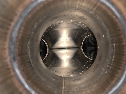

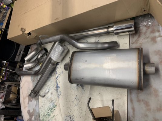

Well, got the kit today and I’m impressed. The muffler is big, case is 22” x11”x6” and the internals is a design I’ve never seen. Looks like an ypipe into a high flow H pipe with dual 2.75” or tubes but stainless perf core everywhere giving the exhaust lots of area to kill drone. They said they developed the muffler to kill drone and it looks like it would. Everything is 409ss but the tips which are 4” double wall straight cut (they said they were slant cut) which is a bummer and they are fully welded on. Installation should be fun haha. Pipe finish looks real good, welds are great and the hanger is a welded ubolt clamp which I don’t love. Clamps that come with it are u bolts but I already got SS band clamps to replace them.
I’m going to clean these up, scotchbrite it then ceramic coat to help with the CT winters. I also got some DB readings of my borla pro XS muffler swap outside and inside on cold start to compare.
