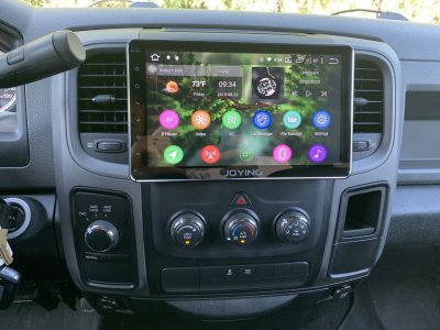

Install Pictures

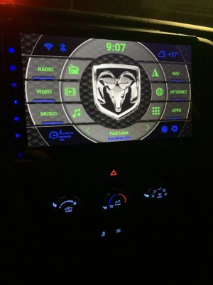

Daytime with Joying default launcher
Nighttime with Car Launcher AGAMA (Physical button colors are customizable)

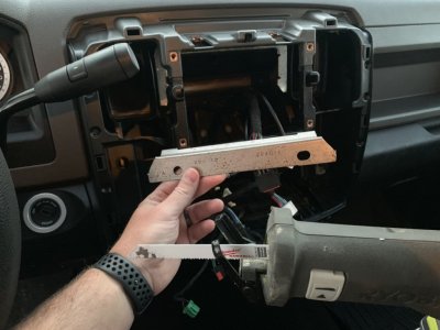

Additional Install Pictures:
Factory mounting bracket that will need to be cut in order to fit double din unit.

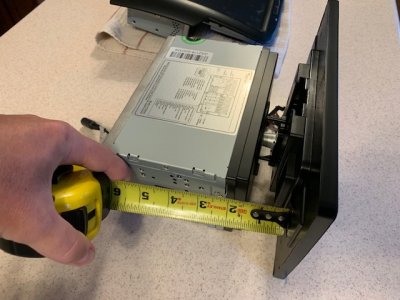

Joying head unit installed with Metra mounting kit before attaching screen.
Note: Be careful not to install the face of the mounting kit upside down or the head unit will be mounted to low.
Side view of Joying unit. Doesn't sit flush because of how the console curves but can't tell from where you or a passenger sits.

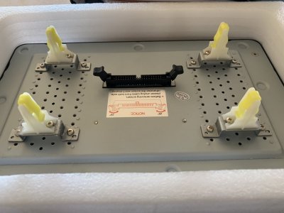

Note: Use the included clip extension brackets for the back of the screen or the screen won't clip in.
