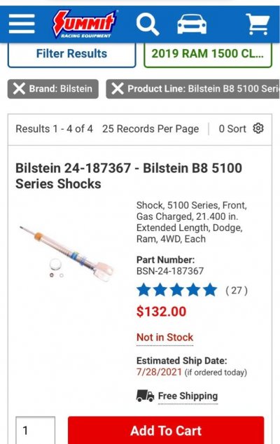

+1 on the Bils. Recently leveled mine with Bilstein 5100s front and back. Used the 2.1 setting and have about 1 inch of rake left which looks good as the 4th Gen Rams have a high hood and if completely level give the nose up appearance due to the meaty front hood. Paid $425 total for the front and rear Bilstein sets. Did my own install which isn’t that difficult. Be prepared to possibly need new strut plates as the OEM mounting nuts are a ****** to get off, you may need to cut them off which destroys the strut plates. New plates are $40 each on Amazon. Ride is more firm than stock but handling and rough terrain is a lot better.
