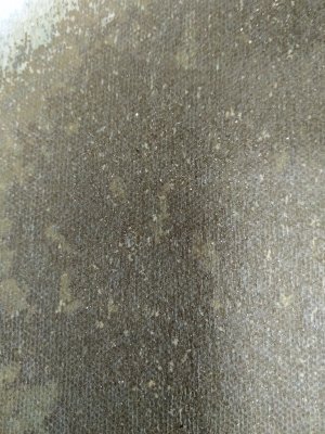

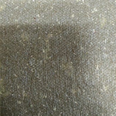

I dyno test engines and we often change oil and cut open filter to check for metal after break in. I wanted to see what things looked like at 500 miles on a brand new vehicle. The new oil was Pennzoil Ultra Platinum 0W-40. I also installed an Amsoil dual remote filter. I didn't use Amsoil's filter adapter, I used the one from Improved Racing. I had magnets on the full flow filter but there was very little magnetic particles caught by the magnets.

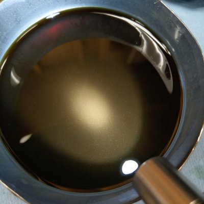

This is the oil from the spin on filter housing after I cut it open. I was kind of surprised by the amount of particles suspended in the oil.

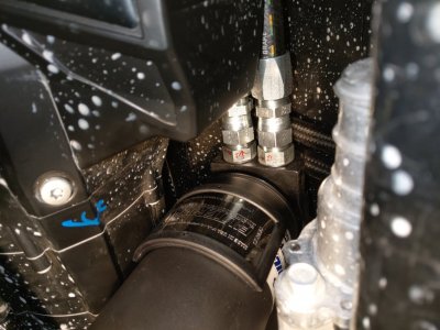

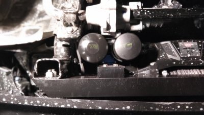

Here's the dual remote installation. I hope the sway bar disconnect won't hit the filters, we went hill climbing and there are no marks. It's not as close as it looks in the picture. The big diameter filter is a fine micron partial flow filter, the smaller one is the full flow. It's about twice as long as a normal filter.

The hoses are high quality USA made with steel AN-10 ends. The adapter is billet USA made by Improved Racing. 1/2" ID is maintained throughout. Zero lag in start up pressure, and there was no change in running oil pressure.
I've used AN hoses for 15 years dyno testing, and have an Amsoil remote filter on my dyno. The filter adapters are cast aluminum for the various engines that get tested. There's never been a failure. If my setup actually causes an engine failure I'll rebuilt the engine myself. If not they are going to have a tough time proving it's the fault of a mechanic who's worked on and dyno tested race engines for 15 years.

I had this Power Wagon to 100 mph in four wheel drive, and to 5500 rpm many times. I've learned from dyno testing that engines shed the vast majority of break in metal in the first few hours of run time. Best break in is to lay on them like a dyno test. Anyway many particles smaller than 20 microns don't get trapped by normal full flow filters (Amsoil), plus if there's enough large enough to get caught the filter can bypass. Either way debris is being circulated. That's why I use filter mags when we dyno test. Some of what gets caught by the magnets is small enough to go through a filter. That's the point of an early oil change, get the break in debris out of the engine/transmission/gearbox. It's also the point of the bypass filter, it filters to a much finer level, 2 microns, than the full flow.
I know this won't double the miles the engine lasts, but like someone said it could prevent lifter failure. I've read the Mopar roller lifters make noise when they are dirty.

I changed my oil around 500 miles and got the similar results and again at 1500 miles, less sparkles in the oil and then again at 2500 miles and sent the oil out for analysis, and it came back as healthy. Seems to be a lot of break in debris. I switched to the a larger NAPA Platinum filter with synthetic, (I don't have the number off hand) media, as indicated previously, the filter is small and it is the same filter I have on my 2011 Compass 2.4 L
