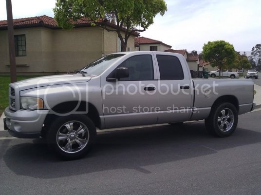

I have this lift on my truck, same year. Ill post pics of it with the 3 inch Lift. Now I have 6 Inches.

Oh nice. Is that the 3 Inch lift on the silver RAM? What size tires are on right there. And post one with the 6 Inch?
