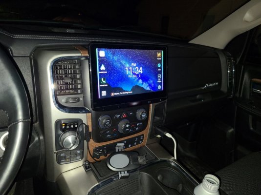

What started as "how do I add Android Auto" to my 2015 CC Laramie with 8.4 Alpine ended up 10" JVC floating KW-Z1000W
Looked at the Infotainment UAQ 8.4 retrofit
For roughly the same money did the JVC, really happy with it
So many more features than the UAQ upgrade:
> 13 band EQ, parametric EQ, many other audio tweaking options.
> 4 camera inputs
> HD display with bonded low reflection, it really does not "wash out" display with sunlight
> Wireless Android Auto and Car Play. Love this feature, no cables etc and works great.
> Screen Mirroring, Wireless with Android and HDMI for Apple or Android
> To many others to list
Bottom line, very happy with this!!!
I have all the factory control options with the following installed:
Idatalink Maestro MRR - INTERFACE MODULE
Idatalink HRN-RR-CH3 - T HARNESS
Scosche CR1297DDB - Double Din Dash kit
What I don't have now?
Uconnect...... who cares never used it
I installed myself, not hard if you have done others before. I would say had about 8hrs in it going slow and careful.
Negatives...

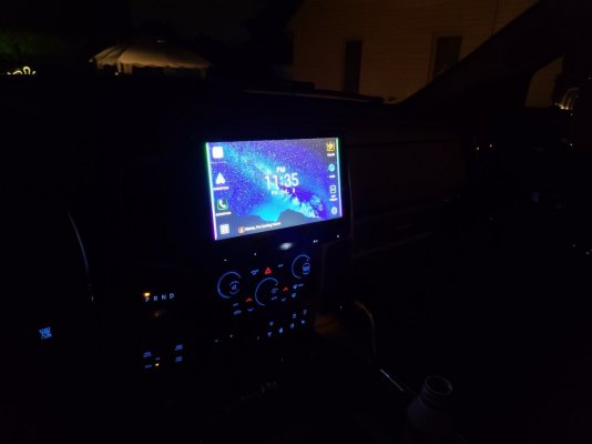

Only really one. The screen is very bright and large at night. The "Dimming" control on JVC settings seems not to do anything.
Good thing is I can use the "screen off" button on my dash and the JVC goes very nearly black (My factory 8.4 still had a distinct "glow" even when off).

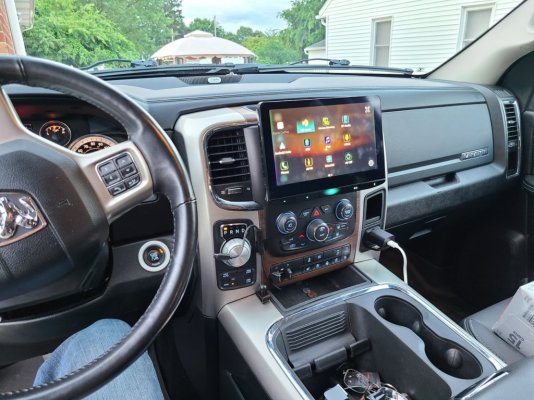

I did the same install a few months ago on my ‘14. I’m the guy who keeps the dash lights pretty low at night. I don’t remember my screen being overly bright at night. You may possibly be missing the auto-dim-with-headlights setting? Not sure if that’s what it’s called, but whatever setting dims the display when you turn the headlights on.
Also… this is a to each, his own thing, but I installed my screen height just like yours at first. Last week I lowered it to the one-up-from-the-bottom setting and like how it sits much better now. The lowest position obstructed access to just the very tops of the dials below the unit so that my fingers would touch the bottom of the screen if I turned the dials. One up from there was perfect.

As for your dimmer, are you sure you used the correct wire in the harness? I know it's been mentioned on 5star car stereo that the wrong dimmer wire is often used, very easy to mix them up.

Thanks will double check the dimmer wire. Volume wise nice thing with Maestro MRR is that the factory volume knob works as well as the steering wheel buttons. Looked at both Kenwood and JVC, basically same units other than user interface design. Agreed like the cleaner (No volume knob) design of JVC and since factory volume knob works why have another one.

Hey Mark,
Did you ever figure this out? Initially I had no problem with mine but I reset the receiver after experiencing another issue and suddenly my nighttime display was blindingly bright. I ended up draping a towel over it last time I had to drive at night. I confirmed that my orange/white wire was hooked up properly and could see a difference in illumination when I turned the headlights on, so the dimmer was working properly.
This morning I finally spent some time messing with it and discovered that there are TWO settings that change the screen brightness. One is in the menu as “Brightness.” The other is in the menu as “Backlight.” I discovered that the brightness setting really didn’t dim it much, but the backlight setting really knocked it down to where I could barely see it.
